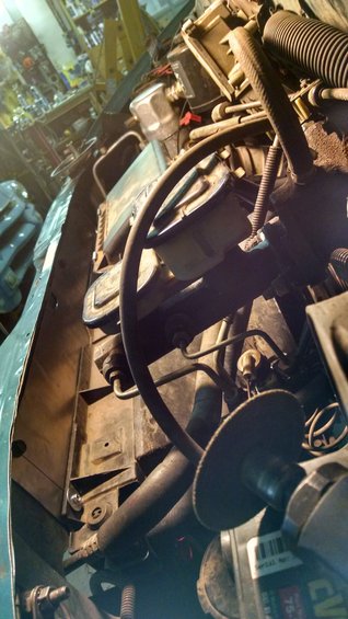

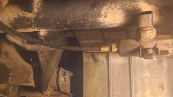

power lock mounted on S-10 front diff
I dropped the radiator down so i wouldn't have to modify the shroud

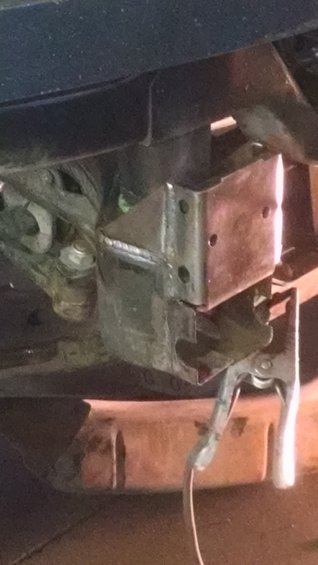

time to raise the bumper

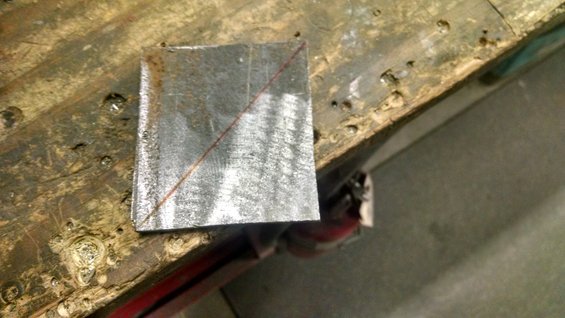

making braces
bumper raised
bracket with brace
yes there is still more pics
all welded up
bumper installed

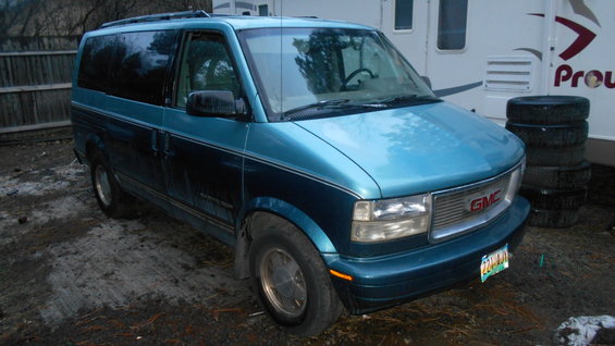

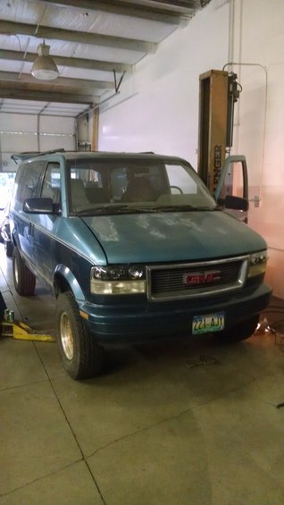

so Started with this
and now I drive thiis
So thank you all for following this but for now im just going to go driving

Thank you for nice photos of bumper relocation bracket and welded upper triangular stiffener.
The Overland 2" relocation bracket appears a bit weak
AP
I am still not satified with the strength of my bumper mounts but for crash impact, a bit of crushable energy absorbsion could be a good thing.
I bolted my bumper brackets using uni strut plate, may need to have machine shop to custom bend and weld some pieces

I was working with no budget so it was make it work or fab it up. wow yours looks good to
