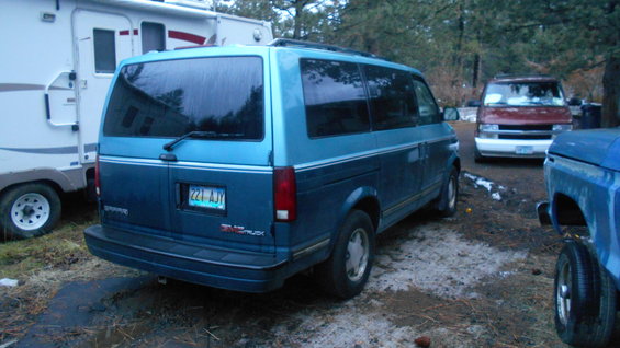

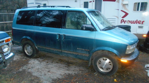

I just saved this 1995 GMC Safari van from the crusher. It has a blown engine which i'm replacing.
My plan is to replace engine an to lift the van roughly 5" on a budget. OK its picture time
s-10 blazer rear leafs an a matching gears s-10 front dif
s-10 233 t-case for my safari
this is where i work so finding things for this project will be easy
this is the 4x4 shifter i will be using to shift the t-case
2000 RWD Astro
1995 GMC Safari 4x4 lifted 5"
